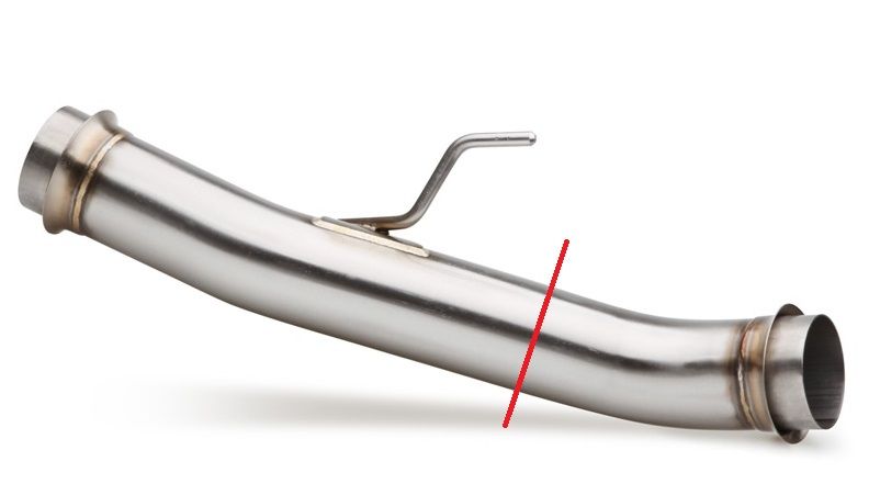

murphc13 wrote:Please post pics when you've got it on!!
Nice choice BTW
I will get some pics & post the details (measurements where to cut the pipe maybe?) murphc13 when I get it sorted, might not be for a little while yet
Should be able to simply cut the lower front section off a MIVV link pipe...hopefully if the angle puts the muffler mounting roughly where I want it as it needs to go out & up at the same time so the pipe will just need to be rotated a little outwards which will lower the angle also which is what it will need
I could always use the other end that has a bit less bend if need be but that may require carefully removing the mounting plate that is welded onto the tube, can be done though
Really couldnt be bothered having a pipe made up (gotta find thin wall 60mm OD stainless tube & make the flange etc...stuff that), might be able to fit it without any welding at all, hoping I can cut it around where the red line is & job done, just guessing though really at this stage until I have the parts in front of me
