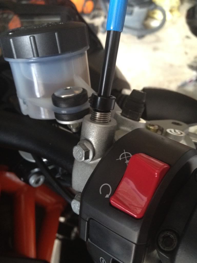

The mirror adapter being left hand thread proved to be a pain as i couldnt find anywhere that sold left hand thread bolts.
In the end i got an M8 helicoil which went straight into the M10 thread on the brake perch. The coil is easily taken out, atleast aslong as you dont brake the tang, so you can remove it to fit the mirrors back on if you want. As you can see i moved it to the clutch side, this was because of the wires coming out the right hand side of the sat nav mount.
Oh and if you have never used helicoils before, they are for fixing nackered threads, realy good bit of kit.
