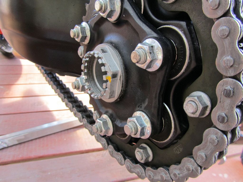

Mark the axle nut and wheel nut with a marker, this will give you a point to return to if you don't have a torque wrench that big.
Take off the clips and loosen both rear wheel nut and axle nut (easier with bike on the floor and someone holding the rear brake).

Undo axle nut till it is almost all the way off but leave it on a few treads.
Tap the nut with rubber hammer or piece of wood so the axle comes out the wheel side 10mm.

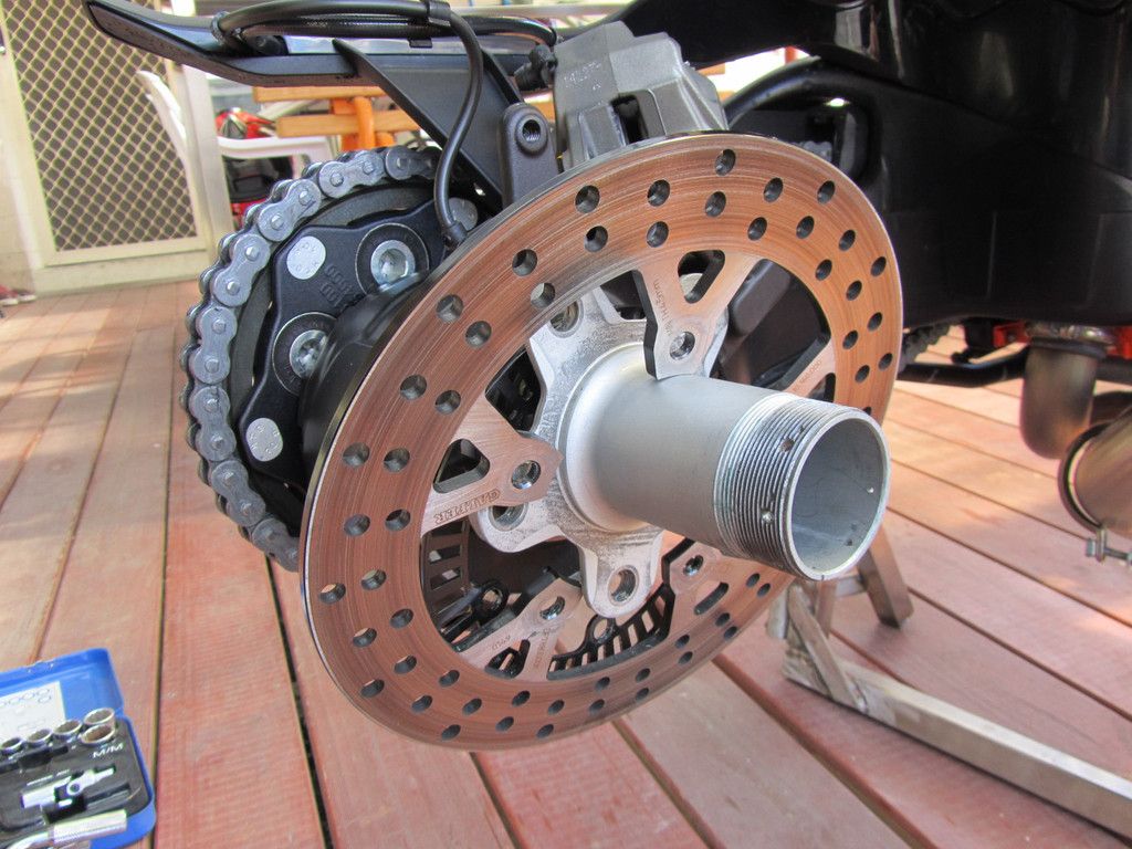

Mark the brake disk and the axle with a marker so you can put it on the same spot (don't think it matters but better safe than sorry).

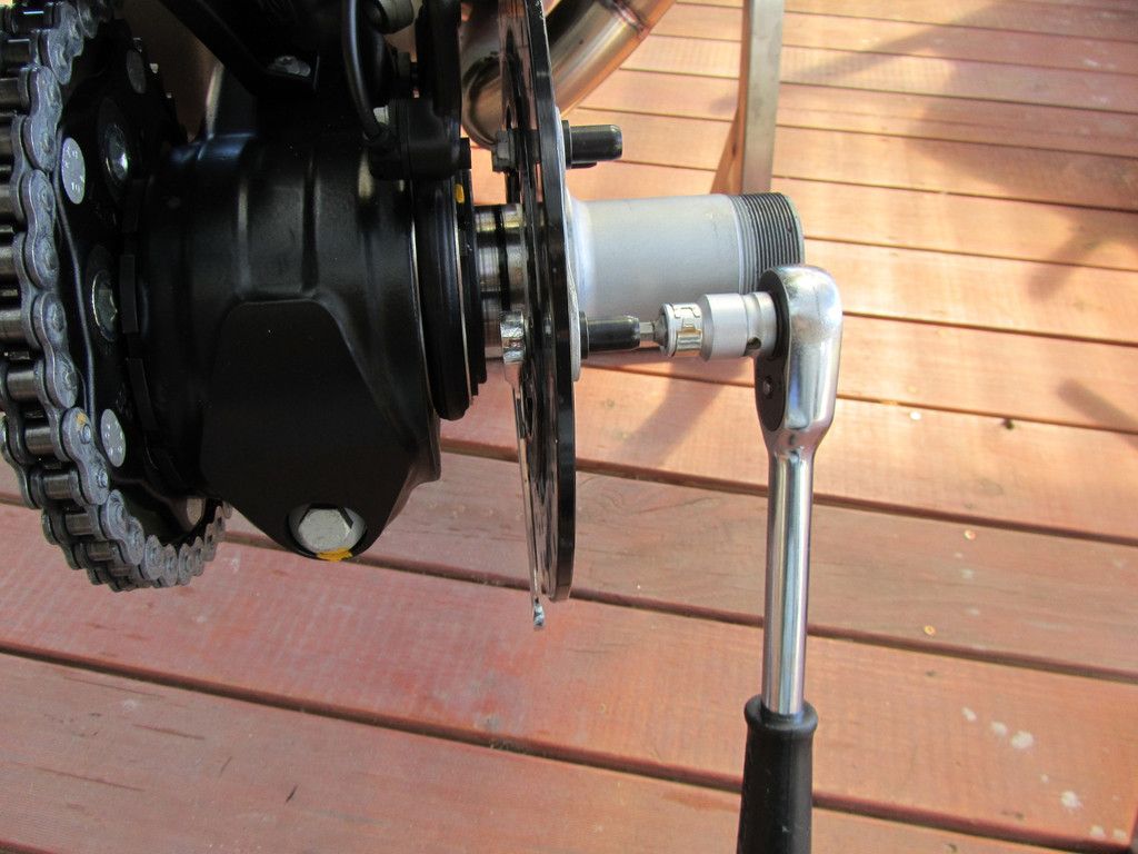

Put a ring spanner on the bolts and a allen key on the wheel guide nut.
Undo all the bolts.
Take disk and speedo ring off as in the picture, no need to remove the axle!
Careful with the disk as it is hardened steel and it easily damages - scratches other things like the axle!

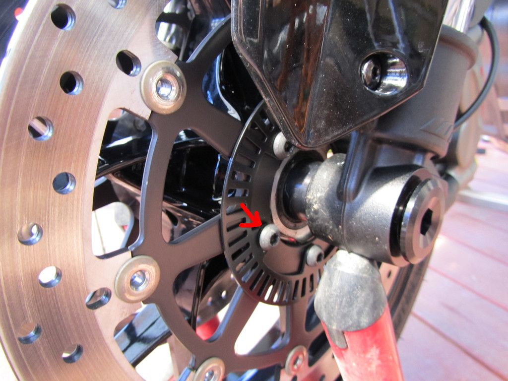

With the wheel in place undo the disk bolts one by one as follows, someone to hold the front brake helps to do this.
Just crank them loose but don't undo them (like half a turn), turn the wheel to do all bolts this way.
Take the bolts out one by one, don't rotate the wheel till you removed the bolt you're working on completely or the half undone bolt might hit something and scratch it.
Take all the bolts out but take care not to drop the disk on the axle- wheel spacer when you get to the last two. If the helper who is there to hold the brake is still available get them to squeeze the brakes as it stops it falling down.
With all bolts removed and the disk careful resting on the wheel spacer take the axle nut off and undo the pinch bolts on the axle head side (right side of the bike).

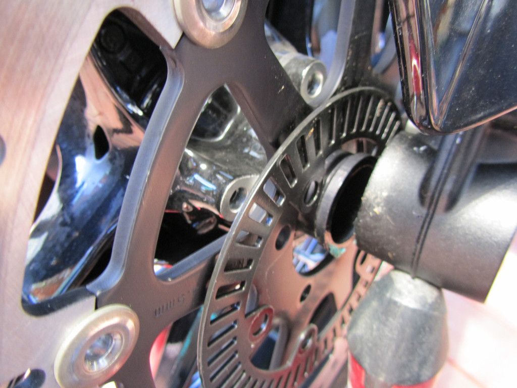

Pull the axle out about 40- 50 mm so it is far enough out to slip the speedo ring out but it still supports the wheel.
Rotate the axle for ward turning the fork legs out towards the front, this created a small gap just enough to pass the speedo ring.
Put the new speedo ring in and refit the axle.
