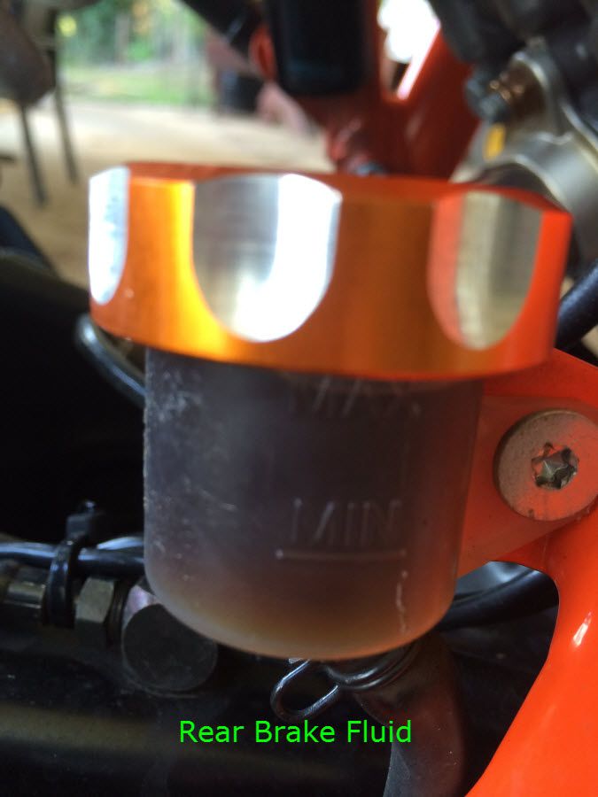

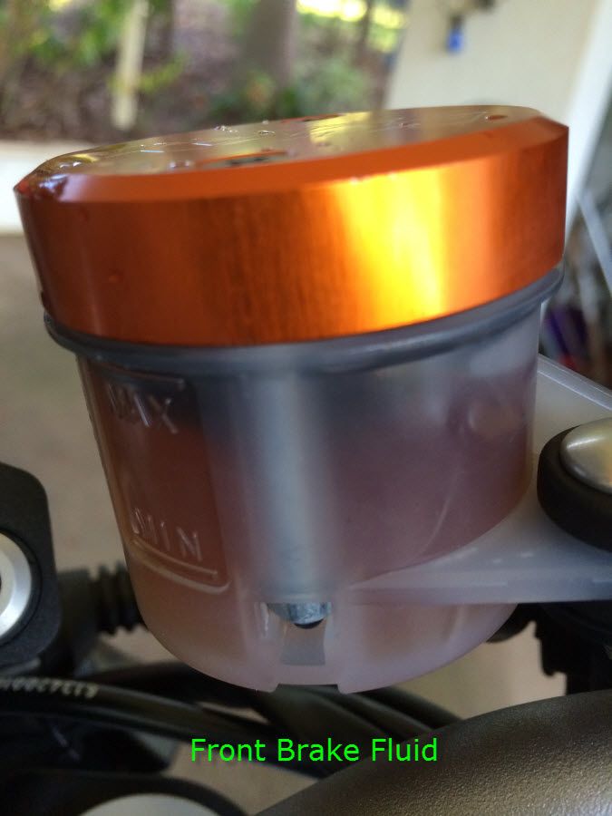

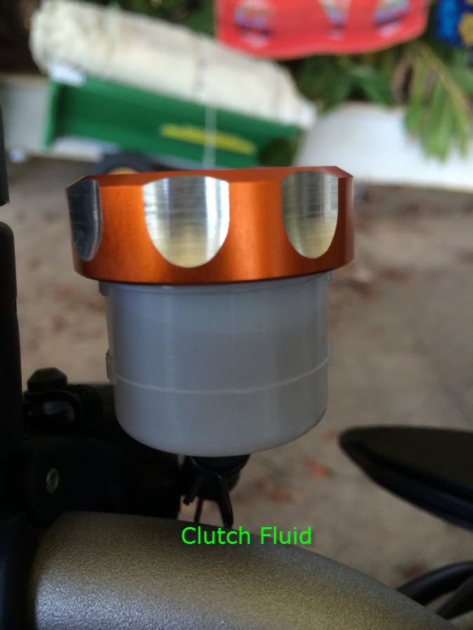

Hey guys, not sure if this is the norm with KTM's or the fluid they use, however mine is starting to discolour quite badly
The clutch fluid has not suffered as badly however both front and rear brakes are not good, can only assume it has something to do with the heat generated by the brakes....

More likely UV damage. Doubt you're getting heat up in the resi!
I've pissed off the coolant. It looked like a lime cordial would when you squeeze the last few drops out of the bottle in a desperate attempt to make one more glass. :lol: If the fluid is the same quality better get rid of it. Can't put a price on good brakes.
I thought I was imagining things as I've noticed similar but not as bad with only 1500km. Better go investigate closely.

Not sure about the 1290 but if it is the same as the 990s then remember that the clutch hydraulics require mineral oil, not conventional brake/clutch fluid which would rot the seals. Check your manual.

Yep the same Magura blood, which will go black over time.
Couldnt imagine that they are uning anything else in the brakes besides Motorex (DOT 5.1?).
If it UV related maybe get a pair of socks for the resi or maybe its reacting with the orange bling?

Also, my brake fluid discolours quite quickly I find. Klinky, every time he sees my bike says, "fooking change your brake fluid mate!" and I think - I did it only a few months ago!

Manual says DOT 4 or DOT 5.1 not DOT 5.
I would rather use Motul RBF 600 or Castrol (both dot4)
If Motorex DOT 5.1 is in now would it have to be completely flushed to use DOT 4?

I believe DOT 5 is silicon based. That's the one one which cannot be mixed.
Best I reckon to stay with DOT 5.1. Highest temp capability. Cast roll SRF is the elixir of brake life :). Bit pricey though.

Can’t tell, is the brake fluid kind of blackish? If it is, I would consider contamination from the seals, a few purges should sort. Same problem with my wife’s Ducati.
UV, nah.

Pissed my fluid off a while back for Motul RBF600 which finnily enough is the same colour the factory fluid had become lol but at least its ment to be that colour. Wanted Castrol SRF but meh... Motul will do for now got better things to spend the money on like rims!
