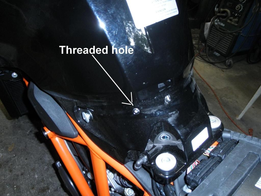

This is the threaded hole in my tank, but it wasn't leaking from there. Went to the dealer last week, and he said it could be a few weeks before any recall would show up. Dynoed at 148 hp, as they had a free dyno day for their open house.

harold wrote:This is the threaded hole in my tank, but it wasn't leaking from there. Went to the dealer last week, and he said it could be a few weeks before any recall would show up. Dynoed at 148 hp, as they had a free dyno day for their open house.
Your dealer is very slack! The recall has been out and well documented by now. I have the paper from my dealer sitting here for two weeks now. And since then the notification has been in the KTM dealers computer.
It doesn't leak from that hole, there is a similar hole at the underside behind the sound proofing and it's there that it leaks as that is a lower point.
Can't see what the problem is to fix it neither.... It's a safety recall, did I mention safety?!
it's either fitting 2 plugs in the holes (30 mins or something) or replacing the tank depending on the situation.

Took my bike to the dealer this morning. They had gotten the recall notice in the last couple of days. I glanced over it but was not allowed to photograph or copy it. Bottom line, as others may have already mentioned, if the tank is leaking then it needs to be replaced. If if is not leaking they have a kit for the tank which looks like two screws with a rubber washer type thing that seals off that area so it will not leak in the future. The leaking tanks need to be replaced probably because the leak ruins the foam sound deadening material on the underside of the tank that covers the 2nd threaded insert that is the one that starts leaking.
